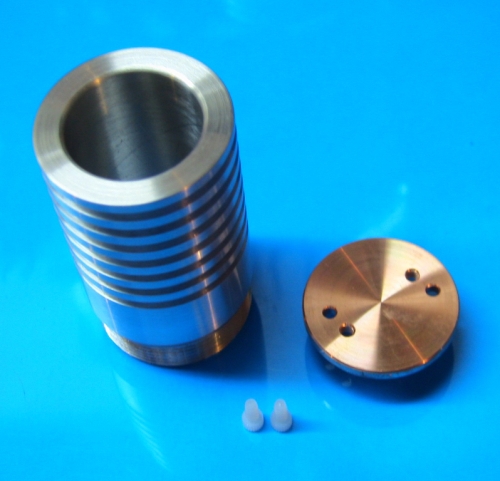

Then the heatsink for the led will go in there:
And then the emitter will screw into the adapter like this:

Now to make up the main blade led:
I'm out of the thermal adhesive pads, and keep forgetting to order more, so i'll go back to using the thermal compound on this one.
I added the male half of the quick-disconnect plug:
Installed the led:
Then added the lens and finally the blade holder:
And there it is:
