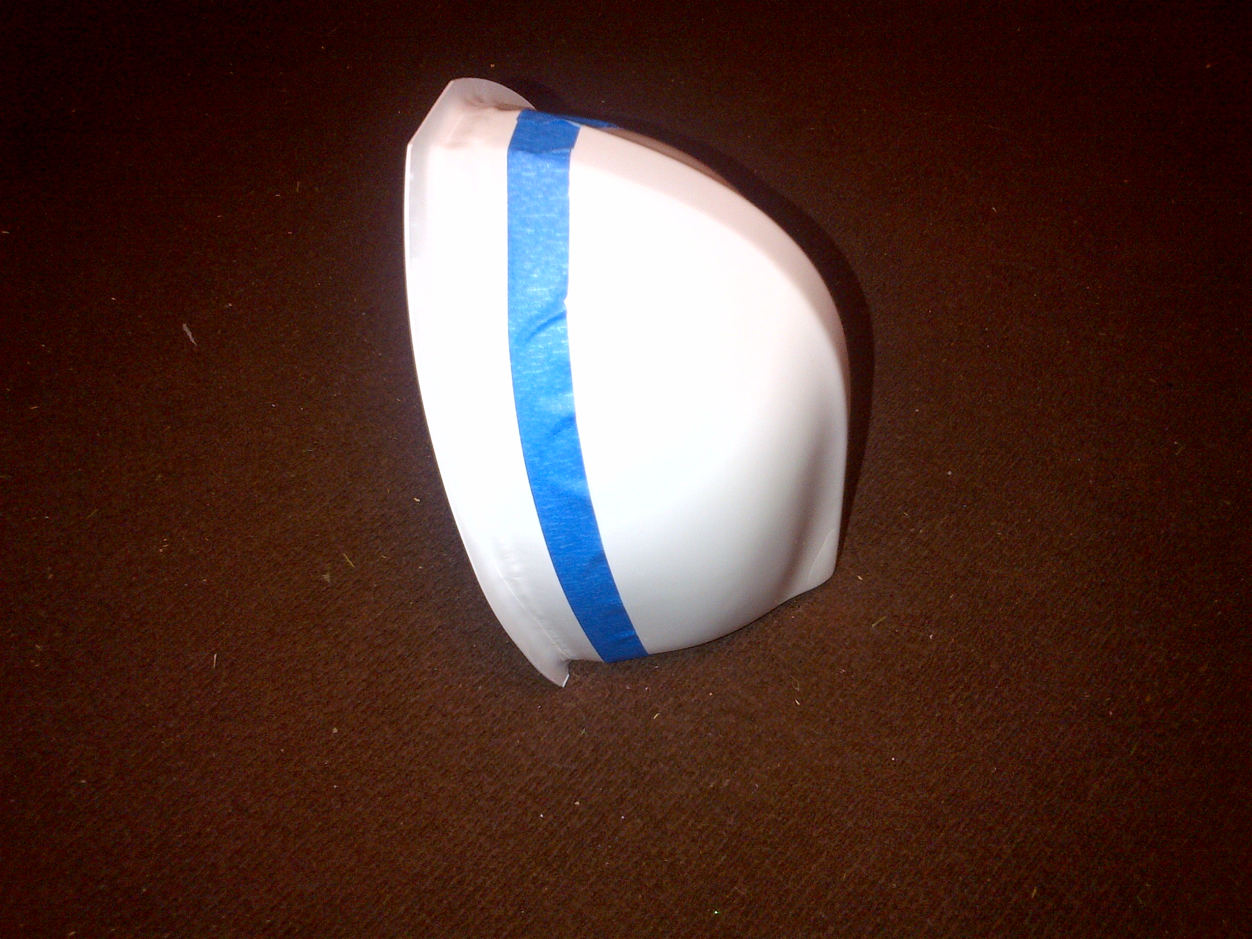

I've masked off the line between the smooth and rough portions of the shoulder bell to give me a line to cut along. What is the best way to cut the plastic? Are there special scissors I shoul use? I see a lot of people use a Dremel but I'm not clear on which cutting attachment they use. Once I make the cut I assume I should sand the edge with a fine grit wet/dry sandpaper, right? This will be my first attempt at trimming so I want to make sure I do it right. Thanks for any advice you can offer before I cut.
- Shoulder bell ready to cut
- IMG-20130820-00025.jpg (1.11 MiB) Viewed 19814 times

I don't have an ATA, I have an AP but I think you wanna cut closer to the rough part. Then if you need it smaller trim more then. Once you cut it, it's gone forever.
There are several methods to cut such as scissors, dremel and score and snap. I recommend reading on whitearmor all of the methods and tutorials you can before beginning this build. I've spent hours reading before making the first cut just to make sure I didn't screw up.
Nobody can tell you the best way to do this for you, it's important to read everything and make the decision on your own. You might be better at score and snap then you are at dremmeling. The majority of mine was trimmed with the score and snap method, but many others used only a dremel. It's up to you.
Good luck!
Good luck!

Truer words can not be said! I read and read and read and read and read. Asked a few questions - then read and read and read.... Taped and measured and adjusted and retaped and read and adjusted and retaped..... Then made my first cut (score and snap) and the panic set in as I hoped it would be OK..... and it turned out great (I think anyway). The first cut is the scariest (start on the biceps - easiest of the fittings)
Take your time do not rush and as the fustration increases (it was a roller coaster for me up and down) take a break. It will all be worth it in the end!

Yep, move the tape closer to the edge, you are cutting into the shoulder bell quite a bit.

Score-n-snap work better for larger pieces and straighter edges. Using a Dremel alone is, to me, a lesson in futility and uneven lines.
Although it's murder on my fingers, I use a pair of scissors that were designed specifically for cutting plastic. Always cut MUCH less than you think you need and use fine-grain technique to get closer to the desired finished edge.
You can always cut more off, but can never put plastic back on if you cut too much.
Once I cut off what I need, I smooth the edges with very coarse-grit sandpaper (like 60) then finish with fine-grain sandpaper.
Cut, test fit, cut some more.
