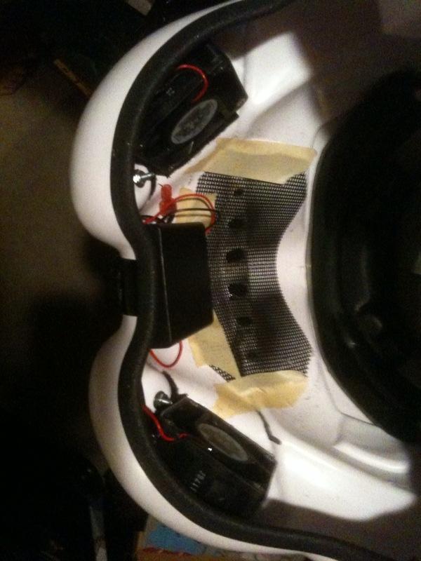

Anyone have suggestions for the best way to affix these inside the bucket? Velcro doesn't seem to hold up...
"Aren't you a little tall for a Stormtrooper?"
Posts: 2882
Re: Helmet Fan
Ive done 4 helmets, and changed the fans out multiple times, and Hot glue works the best for me. Just a dab in the corners that are touching the helmet. With a Stormy bucket, I would use a low temp setting glue. I takes longer to heat up and cure, but it wont warp the bucket. Its worked on fiberglass, resin and a rubies. BUT.. make sure YOU use the low temp setting. Abs tends to warp a bit
And if you need to change it out later, a sharp cut off knife will take out the glue for you.. :thumbs:
Hope that helps. If you need extra help, give me a yell!! :thumbs:

I used Velcro in my Td and I liked how it worked out. When I build my new TD after trooper fest I will do the same lay out once again.

I have been using that too (velcro) but have had it fail as of lately...perhaps i am not applying it in the correct areas?

I think I have it figured out now!...
inside bucket.JPG (55.04 KiB) Viewed 20095 times
